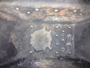

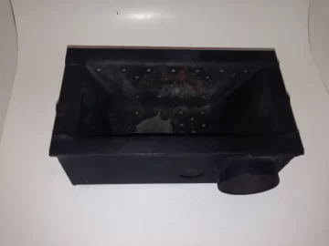

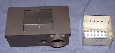

I found this old P2700 because the fire kept dying out! Does that burn pot explain the problem here? ? ? See pics below!
The old 1 piece burn pot has seen better days! ! ! They do not make them like this anymore!
Does the new 2 piece burn pot work better?

I don't know about working any better. I have had no problems with mine. There was someone on here a while ago that complained about the inner pot not lasting very long, burning through I believe. I think I have had mine for about ten years with no problem whatsoever.
I always equate the fire dying out on a combination of pellets & pellet flow/setting. My old '94 won't burn for long on a setting below 3. The smaller the pellet the better chance it will last on a low setting IMO.
Of course, your mileage may vary.
Yes, the new two piece works just fine. I have had several people tell me they work better than the old single piece ever did, but I am not sure if it really does or if it is just someone seeing the first good flame from their stove in a few years making them think so. Probably the latter. However the new two piece does make changing out the burn grate more economical.
Good info, I am sure the 2 piece with the stainless steel insert does last alot longer!
