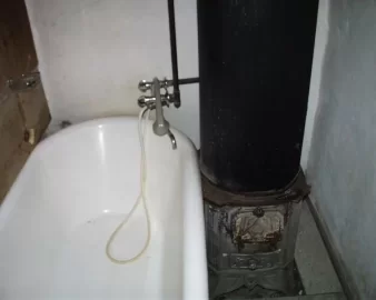

1) My hot water heater is about 40 ft from the wood furnace. I'd be better off trying to create some "instant heat" for the mast bath above the furnace than I would trying to get the hot water to circulate all the way over to the water tank.
2) I'm planning on modifying my furnace (1537g) with secondary combustion tubes this summer. They would end up being installed in about the same location as the heating coil, unless I put the coil right near the exhaust port, which may work too. I'll have to think about that some more.
