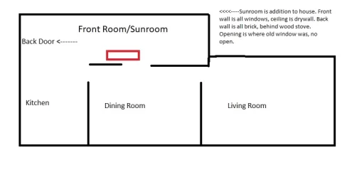

New to me stove just put in (Regency f2400), house is 1800 sqft, stove rated for 2200.
Key is to heat the living room. The red is the stove, above the stove (on the pic) are all windows. Behind the stove is a brick wall (the sunroom is an addition).
I understand pushing cool air is easier. Should I place a fan on the floor at the entrance or far end of my living room? And also a fan in the window opening at the top, moving hot air into the dining room?
Or, any other better ideas?
Thank you in advance!
