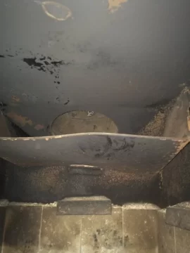

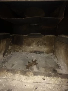

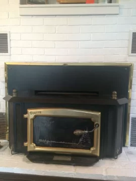

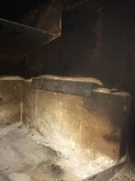

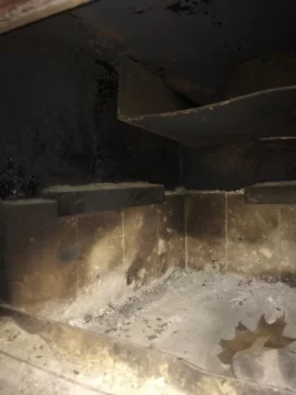

Thanks very much for the reply, I'm attempting to attaching some pictures of the stove... let me know if there is anything specific you need to see.

The only Odette I have ever seen dated back to the seventies. Pretty much guaranteed not to have a liner connected to it but just a "slammer" installation into the fireplace.
The pics posted while I was typing. That is a newer one than I have seen.

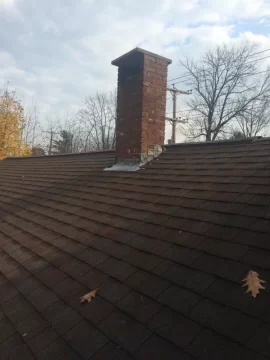

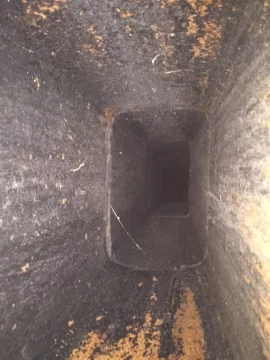

So I just got daring and went up on the roof. The attached photos are the chimney, inside and out, I'm thinking that looks like a liner... Thoughts please!

Yea you need a liner. That is a regular Chimney flue for a regular fireplace. When a stove or insert is installed the Chimney needs a liner. For fire safety. If flue is too big smoke cools in the Chimney and causes cresote to build up and increases chance of a fire. As far as the stove maybe because the baffle there is warped a little but one of the more knowledgeable ppl on here will chime in on that
Well the stove does not look to be in bad shape yeah the baffle is warped a little but no big deal. And it has a round outlet which means it could be hooked to a liner relatively easily. I cant tell from the pics what size the outlet is but you would need to match the liner to that size. With the size of your clay tiles you will have trouble getting anything larger than 6" in there with proper insulation. Even the 6" will need to be ovalized to fit.

A major concern is what the smoke chamber looks like. The flue doesn't look bad but there could be year’s worth of creosote up there. If you use either the insert or the fireplace again there is a risk of setting any build up of creosote in the smoke chamber on fire.

The stove is an older model because there is no EPA device in there, meaning there is no secondary burn tubes and no catalytic converter. The insert will eat wood like you would not believe and give you very little heat in return. I would not buy wood to supplement your other heating because you will spend more money then if you just bought more fuel. Scrounging free wood would be a benefit though. Buying wood for ambiance would be ok too, but you would not save money this way.
