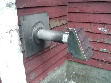

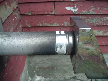

Ok, I guess it is the exhaust hood I need to get off & run a 90degree pipe & extend it away from house more. Notice blackening of house. Do I need a special tool? Thanks!

Should take a twist of maybe two inches counter clockwise. If someone used a bit of silicone could be very hard to remove. I have rubber strap wrenches to aid in removing. Try hitting the joint all the way around with a flat wood piece like a 2x2 to help loosen if it's rusted on. Good luck. Could use metal duct tape to seal the joint or self bonding silicone tape available in electrical dept.
