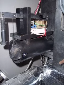

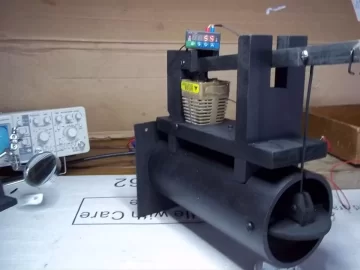

Here's what I came up with that has been working well for two seasons. Simple, economical, effective, reliable, and easy to retrofit. It's just a damper valve connected to a lever arrangement driven by a Taco 550 series heat motor.
It's part of a closed-loop flue temperature control. For on-off control just need 24VAC to open the valve. Fail-safe closure by gravity.
--ewd
--ewd
Very slick setup there EWD - you're running way out in front of the pack as usual! Thanks for sharing that, and when I pull the fan a few weeks from now to consider the possibilities, I will definitely keep in mind what you did as another option.
