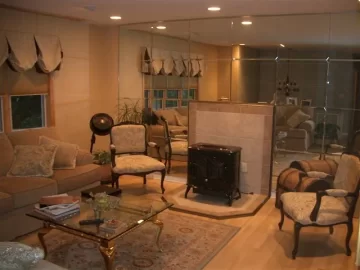

My lady Empress is burning quite well.
Using Hi/Lo thermostat setting so when on low (idle) the flame is mostly
in the burn pot and the blower cranks down, when it calls for heat #5
The pellets fall more rapidly and the blowers blow.
Temp here in NNJ is in the 40's and the house is at 72
Nuttin could be finah
Have a warm and toasty winter
Jay
