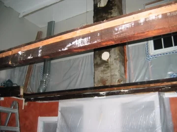

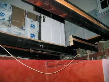

I'm waiting on the engineering for jacking up a 4000sq/ft, 3 story that is 140 years old. I don't need to go far, I'm just replacing a 16ft 12x12 beam that has been compromised by insects. I'll have three choices: Sandwich the damaged beam with lvl's and steel, rnr the beam for a new composite lvl beam and/or cut the basement floor to add another lally column in combination with one of the above. I let the professionals tell me the best way, then its my job to execute the grunt work. Should be fun!
That is one big beam. Out of curiosity how do you go about finding level? I have been attaching a laser level to the basement wall and measuring down from the bottom of the floor joists.

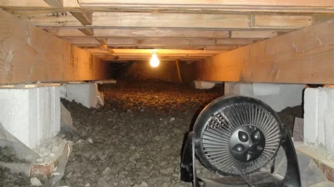

When I moved into my cabin, the living room floor was 8" out of level. I did some jacking, but that was a pretty scary thing laying on my stomach in the crawl space pumping a jack while listening to the ominous creaking of the building above. I'd pump a few strokes, then get out and wait for it to settle, then go back in and pump a few more strokes... when all the windows were able to close properly again, I declared it Good Enough. Now it's maybe 3" out of level, with the only drawback being that I had to cut every piece of wall with a slightly different angle on the bottom.

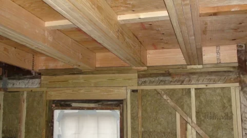

I've leveled more floors than the average guy, having lived in a succession of very old houses (120 years is almost new!). Many will choose to shim on top of the old flooring with laminates, self-leveling pours, or sleepers, but I hate raising the floor level, and doing anything so un-original to the house. If you have the option to jack the house back to square, I'd definitely do all that can be done in that arena. However, you failed to indicate the distance over which these drops are occurring. Also, according to your posted elevations, your room is not just out of level, but your joists are sagging, like a bowl.
It's likely you require a beam at mid-span under those joists, as evidenced by the sagging. This is very common in local Victorian era houses (same age as yours) as they'd run incredibly long spans with 2x6 or 2x8 joists. My last Victorian had a 14" oak beam (it was what presented itself cheaply at the time) installed at mid-span across each large room.
Once the beam is installed and the floor stabilized, my usual procedure is to pull up the flooring, and install the sleepers directly atop the original joists. I do this by setting a laser level between two of the joists, with the laser spinning 3/4" above the highest spot I intend to meet. Then I work thru each joist, clamping a 2x4 to the side of it, using a scrap of 1x lumber (3/4" thick) on top of the 2x4, to level it to the laser. I scribe a heavy pencil line on the side of the 2x4 at the top of the old joist, remove the clamps and take the 2x4 to the shop to cut to the line on the bandsaw. Bring it back in and glue/nail it directly atop the old joist.
Work your way thru the whole room, and voila... flat joist plane. Then you have two options: You could lay subfloor and put whatever you want on top. Or you could go high-class and buy some old-growth or reclaimed southern yellow pine 1x6 T&G (what's used in all Victorian houses around here), and some nice cut nails from Tremont Nail. I've done both, but always feel better about the second option.
For bonus points, you can skip the 2x4's and rip 2x3's on the bandsaw to a full 2" rough width, and use them instead. 100 years from now, no one will know whether that work is original, or something done much later. You can skip clamping them to the sides of the joists, and just lay them on top and mark to the laser line, if you do this. Only down side is that if any of your drops remain more than 1.5" after jacking, you'll need two to make up the height.

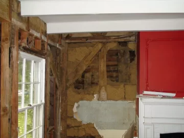

My circa 1810 house 2nd floor looked like the villains hideout on a Batman episode. I went to a structural engineer for advice and did the work myself and replaced the warped 3x8 hand sawn oak with four 2x8's.
Note the saw marks on the hand sawn wood. Also the mud and horse hair they used for insulation that I replaced with roxul and 6 mil plastic moister barrier.
