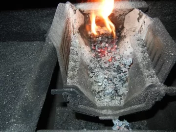

I just bought a house which has a pellet stove in it (a harman pc45). I don't know exactly how old it is, but it is at least 4 years old. I have put almost 3 tons of pellets through it this year. It has two different burn pots. The one with the larger holes is the one using for wood pellets. And one with smaller holes. By holes, I mean perforations. And the harman dealer near here says that the manufacturer is now saying to leave the "stir stick" in even for pellets.
My burn pot is starting to show significant cracks between the holes in the back near the auger where the fire is hottest. I'm thinking about drilling out the other one that is meant for corn. It has smaller holes and doesn't work well with pellets. Does anyone have any thoughts?
I bought a used PC45 with the crosslink and it was two seasons used and now I am into 3 seasons use. I see little wear and burn close to 50% corn without a stirrer. Now there was a upgrade kit that left the end of the tray open for ash to dump off from. The picture show the pellet tray with the upgrade of the cap. Seems to allow the burn pile to get farther out and not get a pile of hot coals at the auger mouth. If your not planning on ever trying to burn straight corn I would go ahead and bore out the holes. There is a change of dip switches also to change the feed.

I have that upgrade kit, but I was having trouble with burning material falling over the edge. I am operating my stove on room temp with the temp sensor across the room on an inside wall about 4 ft off the floor. I also have a ceiling fan that I run on low or medium all the time. I keep the room around 69-70. I've been running the blower on medium and the auger feed on the line between 3 and 4.
Here is a pic of how my stove is now. This is when it it idled back, not burning hard. I did clean out the stove completely this fall before I started using it. I didn't remove the ESP though. I clean out the stove every now and then. If I notice a build up of burnt ash, I have scraped the burn put in between cleanings.
How do you run your stove? Does it ramp up and burn hot sometimes? Does the ash spill over?

In Post Number 3, the stirrer rod (agitator) is exhibiting definite signs of oxidation from an oxygen rich (oxidizing flame, why the ends of the prongs are tapering off. Ideally, you want a neutral flame, not oxidizing and gasification above the fuel bed when the stove is operating wityh a falme thats not lazy but not a ,blow torch' either (and that applies to any stove, not just a Harman
That can also be why your fuel pot is degrading, it will oxidize just like the stir rod does, from an oxidizing flame.
Years ago, I thought I was doing the 'right thing' by dialing in the air and driving the flame. Actually, all I was doing was eating stir rods and making funky fuel pots. I stopped doing that a few years back (throttled the air back) and my heat output increased and 'consumable parts' became non-consumable.

The large hole burn pot holes are 1/8" (0.125"), no sense in just letting it sit on the shelf, drill it out. A new burn pot is $60 from my dealer.
The small hole exhaust plate does work better for my setup, test it.
If you running room temp and pellets are falling off the end of the pot reduce your feed about a half point, keep droping it back till your about an inch from the edge of the pot. Using the short end plate and no stirrer may reduce the blown around ash too, let it fall straight to the pan.
