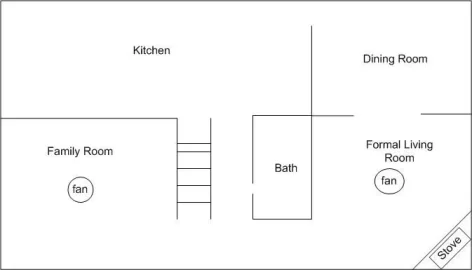

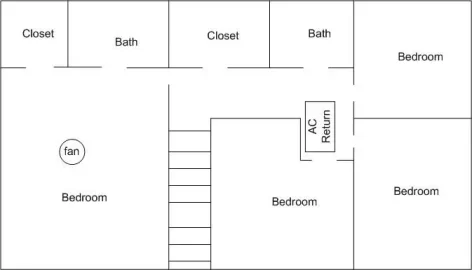

I know there are alot of formulas out they tell you via BTU how many tons I need. But I would like to get some input from you guys who are experinced with the use of pellet stoves. I am having my MT Vernon AE installed at the beginning of september. I have 4 tons of pellets (2 here + 2 being delivered with installation). I was originally going to get 3 tons but went with 4 just to be safe. I am going to heat 2500 sqft with the stove. I'm hoping to keep the temp @ 72 degrees in the room the stove is in and 68 degrees upstairs. I will drop the tempurature on the stove 10 hours a day to 60 degrees. Do you think I have enough? Thanks in advance for all your help.
Sorry I should have been alittle more thorough with the backgroud of my house. It is approximately 5 years old. I usually use 800 gallons to heat 3 zones of heat (3300 sqft including 800sqft finished basement). I will only be heating 2500 sqft with the pellet stove and using space heaters anytime anyone is down stairs (hopefully the solar panels I’m having installed will pay for the electric use). The house is pretty tight and is not draftly at all.

You could certain heat the house on only 4 tons, but I think you'll find you will have some cold areas if you're not using any other heat source. I can tell you that if the LR (where the stove is located) is at 72, your master BR is going to be a lot cooler than 68.
You're probably going to need to add some air circulation to assist the heat distribution. You might want to even consider blocking off the doorway (with a door) going from the kitchen into the DR and install a shrouded fan blowing back towards the stove. This way the warm air will be forced around the house and keep the front side of the house a little warmer than the back, which will keep your BR warmer. I did something similar with a 16" (or 18") shrouded fan I mounted into the bottom of a door (I bought a cheap door for doing this). This circular air flow seems to work very well pulling the air around the house, plus I can keep the side we use most a little warmer by changing the direction of the fan.

It should be pretty close regarding the quantity of pellets you need. Space heaters tend to be a little more efficient, but the problem you're going to have to distributing the heat around the house. Without a good way of moving the heat throughout the house, a 5*F delta might be a little optimistic. You're going to need to do something (as I suggested above) to move that heat around, otherwise you're going to have a hot LR and several cold rooms at the other end and upstairs. If you can spread the heat produced by six tons of pellets, you'll be fine. You might find you still need to set the central heating thermostat to kick on in the cold areas if you can't move the heat around.
You don't think the ceiling fans in the rooms down stairs will help push the heat upstairs?
There is no door between the dining room and the formal living room. Do you think the ceiling fan in the living room and the family room will suffice. Or, should I put a fan in the door way between the living room and the dining room to help move the hot air into the bedrooms upstairs.
Ceiling fans will help (any fans will help). I would focus on moving the heat completely around the first floor and I think you'll find a decent amount of heat will make its way upstairs. The best way to move the air around on the first floor (that I know of w/o going crazy) would be to install a door between the kitchen / DR and install a shrouded fan into the door with the fan blowing toward the LR. This will force the air in a continuous loop around the first floor. If you don't use a shrouded fan (no door), you won't have nearly as much success pulling the air all the way around the house since you can't create a pressure differential. But, as I mentioned, just having lots of fans a everywhere will move the warm air around... but it will feel and sound like a tornado in there plus cost you a lot in electricity. The key is to move the air as quietly, and efficiently as possible.
Thanks for the input. I will test different methods includeing installing a make shift shroud fan (maybe a temporary plastic barrier between the dining room and kitchen with a shroud fan insert).
No, a fan with a built in shroud that can seal off the air... like a window fan. This is the one I mounted in the bottom of my "spare" door: (broken link removed to http://www.laskoproducts.com/fans/model_2155a.html)
Being able to create a pressure differential from one side to the other (if you have the ability to make a circular air path) makes a huge difference compared to just placing a box fan in a doorway.
