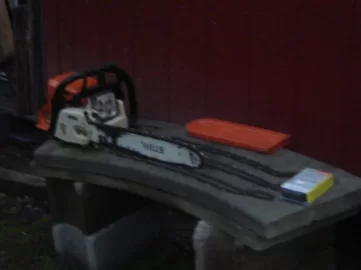

I sold this one for $260 with a few extra chains and a Stihl file guide kit this fall.

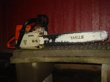

Better picture
