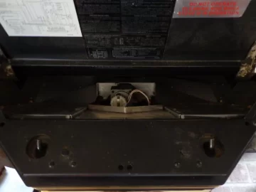

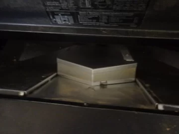

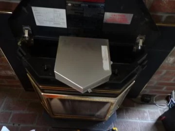

Vacuum out all the pellets, and it's under the raised cover in the hopper. Remove the cover, and unplug the motor. Two 7/16ths nuts hold the auger motor to it's mount. It may take some pulling on it to get it out due to packed in sawdust.

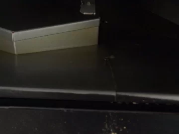

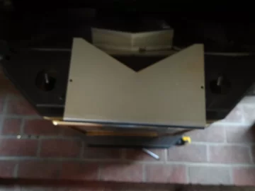

pics might help if you are looking to get at the auger. Here ya go.
