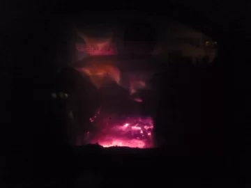

It's been about six weeks since I've cleaned the glass. Crappy pic but you get the idea.
