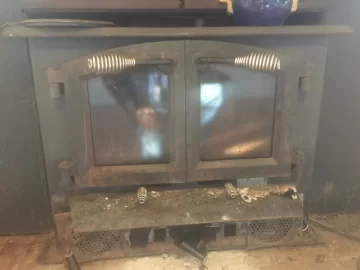

First off how is it installed? If it is just slid into the fireplace as these usually were originally that just isn't safe you need a liner hooked to it

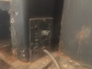

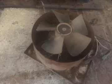

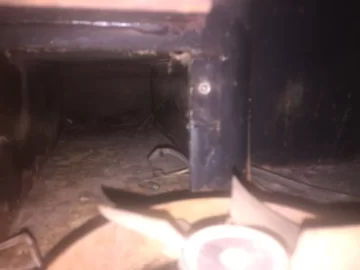

Here are few pictures.
Two fans are just inserted on both sides of the fireplace.
As I know almost nothing about this please be more specific about what liners, etc.
If you know if there is anything on the market that can be used as a replacement for the fans please let me know.
Thank you for your help.

Pull the actual fan motor out and find the model number. Chances are a simple Google search will tell you if they are still available. And if not give you a comparable option.
As far as a liner. Most inserts like yours were simply slid into a fireplace. It was found that this caused several problems. The oversized flue and lack of connection lead to excessive creosote buildup. They are very difficult to clean properly. Because of those issues chimney fires are common and severe.
To fix these problems a properly sized and insulated stainless steel liner should be attached to the stove and run out the top of the chimney
