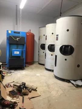

I’ve found that skinny smart people are more of a help than big and brawny guys. Work smarter not harder. I built my boiler room around my boiler and storage tanks, forks on a big tractor and able to access all sides . My boiler was 2500lbs and the tanks were 650 each.
And sell the place before anything needs to be replaced ;)
I used to specialize in tight layouts for combined heat and power plants. In most cases the clients told us we had to fit it in a given space that usually was too small. I would spend a couple of days on Autocad moving thing around until I could have enough space for major components to be serviced and removed. In some cases that might include framing in an opening in a new wall and then siding it over in case something big had to go in or out. The contractors didnt like it as they liked a lot of space for easy installation, but it only gets installed once while it needs to run for many years and that might mean major component replacement.
