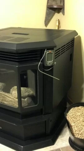

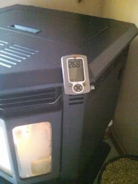

Yes. I can post a pic later. Out of the house now, gotta go to my Sons Boy Scout meeting tonight. Wont be home till after 8.
I used a wireless one ($35) but it broke after a couple days. I have a wired model now. Will post pics tonight.
Well... It took me awhile to get home.. One pic is it burning last season. The other is from today and I let the temp sensor (thermocouple) hang out..... I have a little steel clip that holds the Rod (thermocouple) in the middle of the tube. Cant see it, but you get the picture.
I take it out during the summer mon ths and put the log kit in..
Hope this helps... I hide the wire behind the right door. Like I said before, it looks like it came with it..

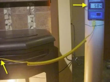

Hello
If you want to measure the wood pellet stove heat output accurately and on it’s highest setting, The ONLY one I can recommend is the $25.00 digital Cole-Palmer and also purchase the high temperature heat probe. Most thermometers do not measure up to 1500 degrees like this one! My Avalon Astoria on low is 250 and high is over 600 degrees F !! see pics below:
See my post below
https://www.hearth.com/talk/threads/52626/
See cole-palmer web site
http://www.coleparmer.com/catalog/product_view.asp?sku=8646003
Large pic
http://www.coleparmer.com/catalog/large_image.asp?sku=8646003&img=86460_03 _05.jpg
This meter has a 4-ft. ribbon micro-cable that allows you to place the probe within an area and close the door without affecting the probe or the door seal. Accurately monitor temperature within freezers, water baths, heating blocks, incubators, refrigerators, and other areas. The meter includes a fast-response type-K probe that can be used for general purpose applications. Users can also choose from a wide verity of probe sold separately for surface, liquid, air or semi-solid materials.
What�s Included:
one beaded-wire type K probe, NIST-traceable certificate, leatherette case, and one 9 V battery
Specifications
Temp range -58 to 1382�F
Resolution 1�F
Accuracy �2�F .75% between 32 to 932�F and �2�F 1% between 933 to 1382�F. Below 32 accuracies are: -4 � 8�F, -40�F � 8�F, and -58�F � 10�F
Probe Thermocouple
Display 4-digit LCD, 0.7� high
Probe type Type-K
Probe(s) included Yes
Dimensions 2 3/4� W x 4 1/4�H x 3/4� (76 x 114 x 18mm).
Power 9-Volt Alkaline battery (included)
Good Luck
Don

I never did any testing on High.. I heat mainly on Low. But 250 is a good average temp for our stoves. The Astoria and the CB 1200 are very similar.
