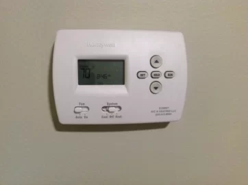

Yes, it should be doable but its impossible to tell you how without seeing the wiring for the A/C unit. It won't damage the compressor. A typical programmable thermostat has RGYW terminals. Y is cooling. G is fan. W is heat. My guess is that his A/C unit has a terminal strip that would allow you to run the wire from "G" on the thermostat to control the fan, but its possible that he'd need to rewire the A/C unit slightly.

As to how to do it, system controls vary, but on traditional / old-skool systems there is a third (usually green) wire running from the control panel to the thermostat for each zone. This wire is for the fan control. Most thermostats include a manual fan override, which will energize the fan. Trouble is, many of those thermostats require you to set the mode to "heat" or "cool", before they will enable the fan control. This can be easily overcome by setting the thermostat to "heat", but setting the temperature well below current room temperature, to prevent the system from cycling. Then you can manually energize the blower from the thermostat.

I simply turn the Fan from Auto to On, and leave the rest of the system off. The compressor is shut off during the winter anyhow.
That's what I was explaining in my original post, but some systems do now allow the fan to energize, unless you're set to heat or cool modes. Most often, this happens when you have any system other than a heat pump (eg. boiler for heat with separate AC), since the thermostat is then set for a mode in which the fan relay only works when the thermostat is set to cool mode. In fact, some thermostats have separate terminals for heating and cooling fans, with a jumper between them, designed to be removed when you have separate hot air (eg. oil furnace) and cold air (AC) systems. Every house in which I have lived since 1981 has in fact had separate heating and cooling systems, and this work this way.
