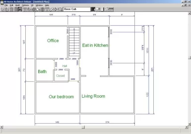

Give the correct sized stove with blower and room doors are left open, can I expect the heat to reach all areas of the living floor?
The stove would be placed in the living room likely in the lower right hand corner, but possibly in the lower left hand corner blowing straight into the kitchen. One of the wifes biggest complaints is cold bathroom!
I just threw this diagram together now because I figured it would help to understand the layout of the house. It is a "cape cod" and the living room is above the garage, but the kitchen is above the basement. House is on a hill. Not sure that really matters much :)
I measured about 715 sq ft of actual floor space, this is not counting closets and staircase (which has a door to it, by the way).

It's a small floorplan, so it should be easy to heat, but distribution through the central hallway will be a bit of a challenge. How well insulated is the house? The first floor will be warmer, but probably not nearly as warm as the living room. A ceiling fan in the living room will help distribute the heat, as would a blower on the stove.
Another thought is to add a small fan in the wall right outside the bedroom door. If it is blowing toward the stove, warm air will be pulled into the hallway.
Is the house currently unfinished up?
Heat will want to go up those stairs. As BeGreen suggested, blowing cold air to the heat source works great.
Any way to knock out parts of walls or put a transom in? The L below the stairs between the Kitchen and Living room is in the way ;)
The closer the stove is to the center of the house, the easier it can heat the whole house--some heat will get to your bedroom through the wall, if you put the stove there. I do think it will also be easier to move the heat into the kitchen from the lower left spot, and you could install a little round vent fan into the wall near the stove to get heat into the bedroom. I think the office and bathroom are going to stay a lot colder. The little doorway-corner fans can help--you probably don't have room in your kitchen for a bigger fan. Bathrooms aren't used for long, so using an electric space heater isn't going to be a huge expense. I don't know about the office, though.
Bathroom is questionable, the office & bedroom will benefit least from the stove, and will naturally be cooler than living room & kitchen.
In that small a square footage, circulation with fans & blower should be easier to achieve and should add a decent benefit.
You might consider a stove fan (I'm waiting for my stirling engined fan to arrive) and doorway fans to extend your heat range.
A reversed ceiling fan also helps circulate the air.
