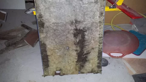

I need new insulation as the 20 year old old stuff started to smoke badly, does this stuff lose its heat resistance over time?
What type insulation material can I replace it with?
Many thanks.
[Hearth.com] HS TARM SOLO PLUS jacket insulation/repairs
Not usually - it doesn't really get too hot in there!
You could use either rockwool or some particular fiberglass made for relatively high temperatures. I think you can find some of this stuff at drywall supply houses, but you can also see it on McMaster-Carr
example:
http://www.mcmaster.com/#9328k41/=ppyhk9
Most of that boiler is surrounded by water - those surfaces will never pass about 250, but any single wall surfaces (maybe around the flue and cleanout area) could hit as high as 800+ degrees.

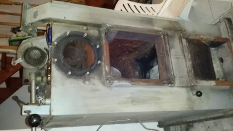

I fired it up the other day without any water in it to see what else needed fixing as I thought maybe the door seals were gone, so it did get hot then without the water. I hope its not a problem to do that, to run it without water....
Anyway as suspected all doors were leaking smoke badly when the fan turned off. I did get it to start gasification but for some reason the flame cut out after about 20 minutes and then smoke came up through the fan and doors...dont know why it cut out as the fan was running

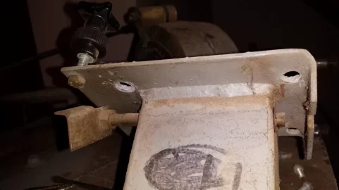

So I have stripped it down to find out whats up with all the smoke coming back through the fan, and there is a small flap in the air pipe that controls air flow? Should this be spring loaded or its just supposed to stay open even when the fan is off?

The boiler is not designed to be fired up without water in it! Not sure where you came up with that idea, but a boiler like this maintains about a 200 degree temperature in normal use (the steel), while it can be 5X that without the water...or even more.
Firing a boiler without water is like running a car engine without water.
As I remember, that flap was weighted or something like that so it would close when the fan was not running. However, none of these assemblies are really designed to be "smoke tight" to the degree you may be thinking.....so unless your chimney has some kind of a draft, you are going to get smoke.
Also, remember that these boilers are usually used with storage - in most of those cases, the boiler runs the vast majority of the time (or all the time) with the fan on.
The importer should have the new door gaskets as well as the door mounting gaskets.
