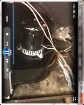

  • How do I oil the convection blower (photo attached). I see the oil ports in my old FASCO all black blower, but I don't see them on the new one. I bought 3-in 1 oil (blue and white bottle)

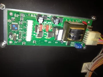

  • What could be going on with the control panel auger and fan light indicators? (I've attached a pic of the control board). I have the newer control board (the one without the Saranac logo written vertically)

Is that control board the newest one, because if it is (and my eyes aren't deceiving me) you have the board configured for the wrong firing rate (too high) and your convection blower will not remove the required amount of heat from the exchanger and it will both cause the convection blower to thermal off and back on.along with cook stuff inside the shell and eventually lead to a hi limit shutdown.
I'd get on the phone to BAC and have them provide you with the timing information to correctly jumper that controller.
The light you are calling the auger light is not an auger light it indicates if the stove is on low fire if blinking and at the firing rate selected on the panel if on solid.
The light you are calling fan is actually the light that indicates the auger is energized.
Those labels are for the buttons.
The fan button is where you can turn the convection blower on high or let it float with the heat range.
The auger button is for manually feeding pellets by energizing the auger.
There should also be a snorkel installed. To get the motor away from the firebox (I also hope there is a gasket between your current motor and where it attaches to the heat exchanger).
I can't speak to that particular blower as I have never used it there should be lubrication information on the motor makers plate if it can be lubricated.
The current blower I have is not OEM or one of the string of attempts at solving the problem.
Now if I was 100% certain that the controller was the latest universal one for the stove line I'd tell you to change that jumper over to the two right most pins but since I'm not certain I'm not telling you to do anything.

The auger light should not be on all the time, but to be sure as to what is going on there, I would recommend you attach a volt-meter to the auger and see if the 120 VAC is constant or intermittent like it should be. That will definitely tell you if it is a bad control board. If the voltage is constant the control board is bad.
A snorkel prevents the convection blower from getting to hot. I measured over 130 Deg F on the blower flange when connected to the stove directly. A snorkel does help and BAC should send you one. On stoves without a snorkel you can put a nice 1/8" thick Silicon Rubber gasket to help absorb the heat and vibration. It works better than the original Lytherm gasket in there.

Thank you all very much for the info. I will call BAC and confirm if I have the latest control board with the jumpers set correctly.
I will also get a snorkel. There is a lytherm gasket for the convection fan now.

I haven't had any trouble with the auger jamming, but I will check it with a volt meter.
