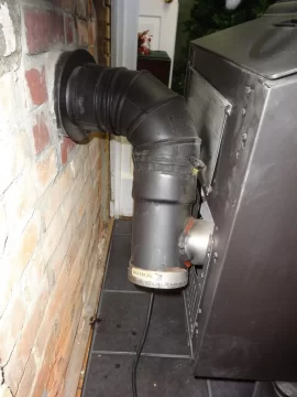

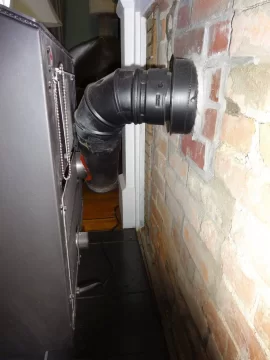

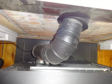

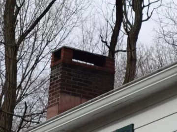

Good afternoon SmokeyTheBear and Doocrew.
I'm sorry it took me so long to post the pictures. I'm not normally home during daylight hours. I attached three photos of the exhaust connection (from the right, from the left and showing the drippings on the floor, and from above) and one of the bluestone-topped chimney. It's a wide chimney but has only ever had one flue in it.
The repairman came the other night and said that the problem was a dead exhaust temperature sensor (or relay?) that had come from the factory bad. He tweaked the fire using feed rate 2 and combustion blower 3, and instructed me to leave those settings alone and just adjust the air shutter whenever I change the temp setting. The stove has been running well for the past two days and is once again lasting 12 hours on a full hopper of pellets (so it stays on overnight)!
He also said the creosote drippings would be a problem for a wood burning stove because it runs hot, but are not worrisome from a pellet stove. I doubted that, so he explained that the black spots which dripped onto the hearth pad come from the chimney lining heating up and "sweating" off small amounts of buildup, which run down the liner and drip out the seams between the stove pipe segments. Does this sound good to you?

Ok where to start.
Creosote is a problem if it gets into the exhaust stream close to the combustion blower and pellet stoves do burn hot.
If the creosote gets on the heat exchanger (where the ash rake is) it is sitting above a very hot flame and can light off.
Why there is creosote in a burn system is always a cause for concern.
You are dumping your exhaust into a masonry chimney which based upon what your repairman is saying is the source of the creosote, this means that the pellet stove exhaust system isn't going up the full length of the chimney and properly caped
Which leads to this possible situation.
4. You can vent the stove through an exterior wall behind the unit or connect it to an existing masonry or metal chimney (must be lined if the chimney is over 6” (15 cm) in diameter, or over 28 inches² (180 cm²) cross sectional area)
If the exhaust venting is exposed to outside elements that allows water in then some of that is going to find its way into the stove under certain weather conditions.
Now exactly what is the chimney's flue size? A 6" flue is 28.2744 square inches in cross section. If that flue is say 6" x 6" (36 square inches) it needs liner.
The sensor is a run of the mill 120::F close on rise ceramic air stream thermo disc (aka snap disc, POF) those puppies are usually solid units (part number 39 on the exploded parts diagram).
The pile up you had was the result of an airflow issue either the damper, or trim control wasn't set correctly for the venting or fuel or the stoves exhaust blower couldn't keep the airflow going due to the cross sectional area of the flue. In any case cruding up of the stove proceeds at an accelerated rate, you just see the end result.
This can lead to that thermo disc not seeing the correct temperature because of ash and soot during the start up window and the stove shutting down the controller should show a blinking #3 heat range led when this happens. Yes at 8 hours on heat level 5 you can easily empty a 45 pound hopper. This also causes a blinking #3 heat range led (the stove doesn't know why the snap disc isn't closed and doesn't really care.
However a properly setup and trimmed pellet stove can indeed burn on lower heat levels. In fact heat level 1 is the normal piloting level when running in hi/low mode on a thermostat.
