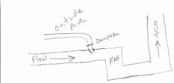

I found an install picture of a drum system that looks like it bypasses all HVAC equipment. I also did a quick drawing of how I pull out side air into house without extra fans, (venturi effect I think). I bring in outside air, filter it, heat / cool it and goes out to the home thru the ducts. You do have to watch out for freezing your coils in winter etc. But this works well for me. ( my 50% humidity reflects the warm rainy days we've been having to some amount )
If you were to install like the picture from http://www.cornerhardware.com/howto/ht081.html and on the line where the humidified air returns to your duct you had a little scoop I think you might get all the suction, through venturi, you need. My scoop is pulling air through 25' of insulated plastic flexduct and I keep the damper bout 1/2 closed because it sucks so much. Could you mount the unit on one end, before HVAC and duct around with plastic duct?
