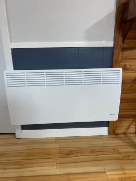

You can buy a lot of electric for that much money.
These 2000W (or 1500W) heaters are a good way to get some extra heat when needed. If you were to calculate the cost of ownership compared to wood or heat pumps (for running part time) it's going to be way less. Still, you need power. If you already have a way to heat during a power outage, it might be worth considering.
  • [Hearth.com] Who did your install?
Reactions: djlew and sloeffle
