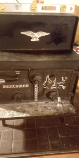

This is the stove I found out it's a model 4020. I'm try to get are permit and we need to hand in some sort of manual to the inspector.
If it doesn't have a ul tag on it the manual really shouldn't matter. They will just revert to the unlisted defaults
Bear in mind that unlisted stoves have serious clearance requirements- 36" all around, 48" above, 18" of ember protection in all directions from the edges of the stove, and if the legs are shorter than 6", you are also looking at an air-gapped hearth to set it on.
It's a much bigger hearth area than most people have, and legs under 6" add to the complexity and weight of it all.
Bottom line is that you probably can't install an unlisted stove on an existing hearth and call the inspector over- unless the hearth was specifically built to accommodate an unlisted stove.
On top of that, you have the possibility that after all that, your insurance company will refuse coverage if you have an unlisted appliance, even if it's installed correctly and the inspector okays it.
