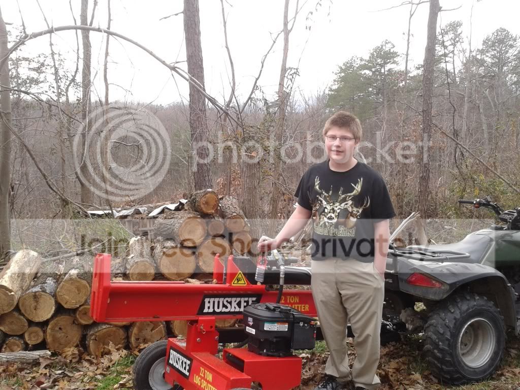

This is my 13 year old neighbor kid Nick - 170 lb. ox with size 14 shoes. He's gonna be quite the lumberjack. He reminded me to take a picture for "logbook or whatever that site is...."

That was cool of the guy at TSC!! That pic reminded me of what my splitter use to look like...clean. I check all the places that could possibly vibrate loose at every oil change. The only part that failed on me was one of the pins that hold the ram in place. Apparently fell off and the complete ram assembly fell during my 1st vertical splitting session and just missed a serious hand injury...scared the crap outta me. This is the reason I check everything to be tight at oil changes. I love this splitter though, has done everything I have asked of it and except in really cold weather it has been easy to start too.
