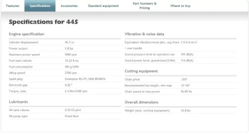

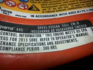

I purchased a 445 18" bar a few months ago and would like to take the time to say what a great saw it is. It feels lighter and more balanced than the smaller pp3516 it replaced. She inhaled and spit out some black locust and oak rounds about 18" effortlessly, noodled big rounds and y crotches no problem. The only negative is that the bar nose sprocket got stuck with wood chips on two occasion which took about 10 minutes to clear. I pulled the serial number off the saw for a warranty claim and noticed the 50cc label on the handle. now i'm really curious because the website listed the 445 at 45.7 cc

The 445 is a 45.7cc saw.

bought it as a factory refurb with warranty. The bar sprocket froze before a half cord and they gave me a new bar today. Yes, I see where the website listed the saw at 45.7 cc but on the actual saw it says 50cc. I also found another review on amazon.com stating that their 445 is listed as 50cc in the manual.

I do know that a lot of saws in the same chassis/model family will share the same manual (like Stihl 290/310/390). Doing a quick look on Husqvarna's website, the 445 and 450 do indeed share the same manual during some production years.
I'm not totally sure about the sticker, but it may have something to do with model or model family registration. That is, it might be that only the 450 (50cc) was submitted for emissions testing, and when it passed, it meant that the lower displacement 445 (45cc) also passed because it's the same saw with only the piston & cylinder being smaller.
That's a good point TreePointer. Maybe I'll give husqvarna a call on monday. no big deal either way its still a great saw.
