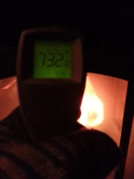

The original post was about a Eco-45 or did I miss something? Yes. You have a nice stove and according to you, my stove would have never kept up, but at 4 pounds a hour I don't think it has to much of a problem staying with the pack. In one of your other posts you hit a high of 600 F at the heat exchanger. I hit that mark on stage 3 running a mix of Trebio and Satisfation and capped it off at 732 F. Funny thing is, I still have one more heat setting. As far as a 4 cyl to a V8 comparison, I like to think it is something Smokey” Yunick and his Buick V6 days would have dialed in.

There have been cases of the eco-65 going to 1000F if your willing to push it long enough, but I prefer not to do that. You have a great stove for its Rated output, I do agree, but BTU's are BTU;s and less is less heat, pretty simple..
