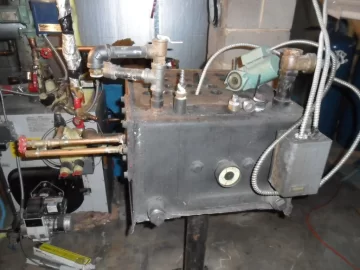

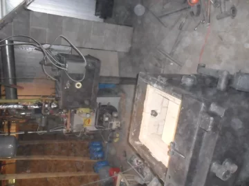

The first photo is the unit done the tanks are not insulted yet and you can see the backup oile boiler in the back. The second is the top tank with tubes I welded to the bottom boiler I made.

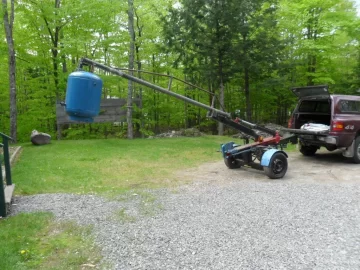

The first photo is top tank again with bottom tank i made you can see the secondary chamber air inlet pipe, the second is log splitter with propane tank going into house.

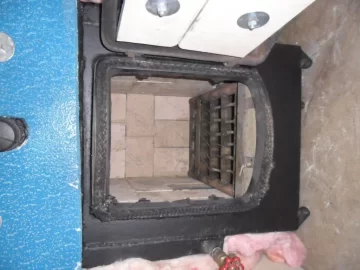

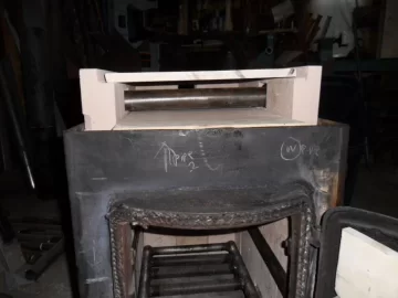

Hi, I live just north of Lincoln, The fire box bottom is 14 wide 19 long 18 tall,I have 2.5inch. by 14 wide opening from bottom chamber to upper then 4inch. hight in second chamber 16 long. I put a 2.5inch. baffel[choker] 1/3third way in second chamber to cause tubulence in air. I inject air in very bottom and top of first chamber then right in back of second,you can see the flam come from the 3 holes I put in it. all these I made ajustable to adjust air inlet. second chamber turns red hot.
The first photo is second chamber before I welded 6 more inch. on sides and pipe is just there to line up brick[would melt] I used Cordienit for baffels[can cut with masenary blade] next photo is bottom chamber.

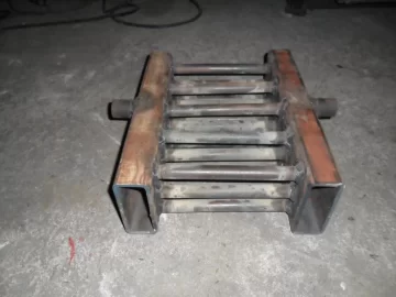

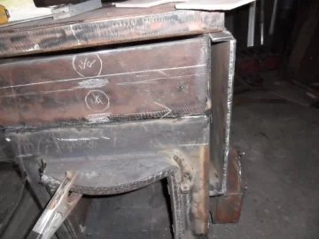

Photo of welding side water jacket on and one of the very top heat exchanger I added right before goes into chimmey to get last bit of heat out of gases.
