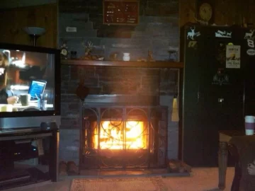

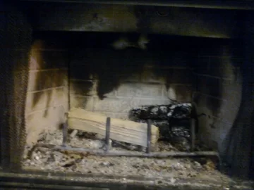

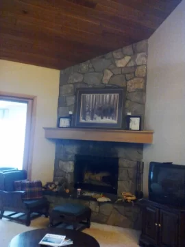

Pics. of my new condo- the fireplace is pre-EPA & eats through a lot more wood than an EPA unit, but right now, I'm just happy to have any sort of wood stove/fireplace.

Congrats, Mt. Ski Bum! Nice looking place, especially the hearth.
Not to bust your bubble but thats a helluva lot of soot/creo between the lintel and mantle dont you think Bum? On a second look theres alot in the box itself too. That doesnt seem right in such a newer looking home.

There does seem to be alot of soot there. Is your wood dry enough? Do you hear any hissing when it's burning?

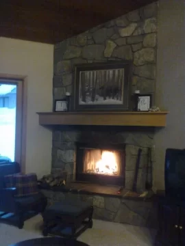

Looks almost like my Fireplace in my home. Except the Soot. I have the same Cheap "Brick Walls" too.. But No fear.. Only $200 and that thing will be a MONSTER.... . I Put a "Tighter" sealing door set on.. Along with a couple other things. An "adjustable" damper (Factory is Wide Open or Shut), and bigger CFM fans in the bottom (2X), for better convection heat. I get a Hotter, Longer fire, with the Doors Closed tight and Fans on High. A 4 hour burn isn't bad out of a "Full Load" on a Fireplace... At least I don't think. About an Hour longer burn with my Mods and the Soot is cut down also.. The Soot was always there on mine (before) with the driest wood. Don't know why.. The white face brick helps show a lot of it. I bet if you take your finger to the Soot, the "Black" will wipe right off.
Anyways... Congrats... Nice Fireplace. Even without any "Mods" that fireplace will SCORCH you out. Keep the fans clean of dust in the bottom...... I had mine fired up the last 2 nights. This is the pic I posted from a Thread in The "Pellet Mill and Multi-Fuel Stoves" Thread.. "May 15th and I;m still burning"??
TV.. Looks close. Depth is decieveing. But with the Doors closed and the fans running. It does not even get Hot..

Those pics (except for the one with the fire going) were taken before I had my 1st fire, so it was there before we moved in. The condo isn't really that new- it is in one of the original groups of condos built in Big Sky back in the mid-70's. I went into Bozeman today & bought some stove cleaner from one of the stove/fireplace stores- the gal at the desk said it works great on the glass, as well as the stone surround, the sides of a stove, & pretty much any other part of a stove/fireplace that needs cleaning- it supposedly is a good bbq-grill cleaner as well. As soon as I get a chance I'll wipe that area down.
Olso- yep, my wood is very dry- it's deadfall lodgepole [pine] that's been split for probably over a year now. No hissing when it burns.
Dexter- I might have to check out those upgrades you mentioned- the doors on it def. don't seal. Might contact my landlord sometime & see if he'll let me do those upgrades. As for the fans, I don't believe this fireplace has any sort of fans- that I know of. The damper on this one is the same way- I think it's ment more to block downdrafts through the chimney than to control the way the fire burns- especially since 1. the lever that controls it is located inside the firebox (i.e. not something you're going to try to adjust when burning), & 2. it's one solid plate w/o any holes- unlike most of the dampers ment to control the fire that I've seen- did your original damper rotate open/close (the damper plate is vertical in the open position) also, or did it slide in/out? The TV is off to the side- out of the "direct line of heat" coming from the fireplace, & it's about 5 ft. away also.
With those upgrades, I might actually be able to get it to heat some of the living area better. Right now it mainly heats the chimney & the air above the roof. lol
