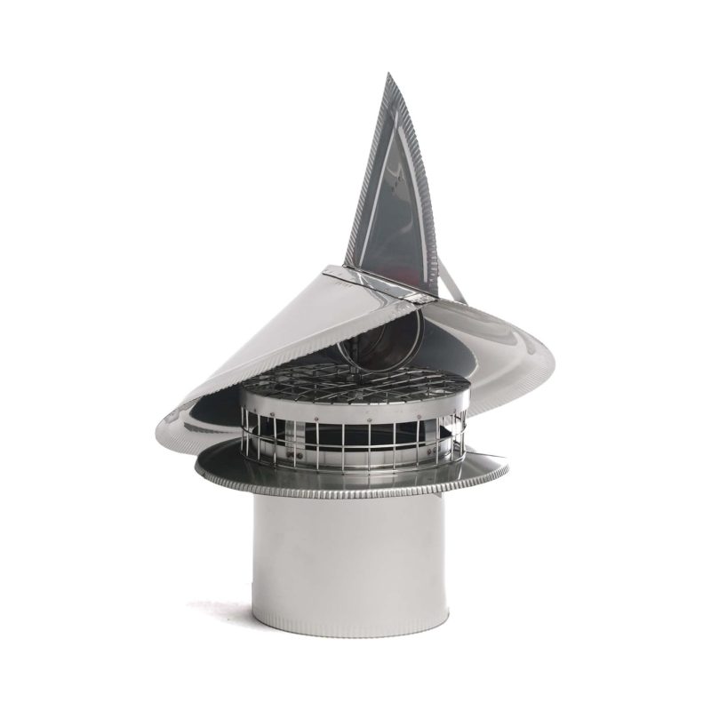

I have a wind problem. We live on a plain and the wind is commonly a sustained 10-20 mph. (Yes, it sucks) It causes the flue to draft much harder, making the stove get hotter than I want. It's 75-80 in the house when the wind blows unless I open windows.
Does anyone have experience with different types of caps to reduce wind induced draft? I have an Excel chimney and was considering adding the Rain/Wind Shield. However, their claim is that it INCREASES draft by 40% in the wind. Not exactly what I want. I think that's a misleading statement though. I'm thinking it increases draft in situations where you have a problem with negative draft, but decreases draft when you have my issue. A buffering effect basically. Anyone with real life experiences?
Flue height is the minimum recommended for the stove. Stove is a King. Not particularly interested in a damper.

1600sf manufactured home. 2x6 construction with fiberglass. Part of the problem is the size of the house with the king. Mid 40 outdoor temps is when the house starts to get too hot though when it's not windy, so there's not usually a problem.
One solution is the rooster-tail style, wind cap. Another is a Vacu-Stack cap.
I would think the rooster tail style would increase draft. Maybe that's not correct though. Maybe the vacu-stack would work too. Seems like it would. I think I'm leaning toward toward a "storm shield" like the one I have pictured. I would probably turn it into swiss cheese by drilling a couple hundred 1/4" holes in it. I'd think that would create a pretty good buffer against the wind. I'm leaning toward this because Excel sells it for their pipe. It's not clear what size Vac-stack I'd need to buy for 8" pipe, or how I would install it. Excel pipes have exposed insulation that requires a pretty tight fitting cap to protect it.

That's the other obvious answer. They can be expensive and troublesome though. I don't the idea of worrying if I forgot to open/close it. My decision is made easier by the fact that Excel doesn't appear to make a damper for their 8" pipe; just 6". Since I have a wind issue via the venturi effect at the tip of the flue, not a draft issue caused by flue height, I'm trying to employ a bottom up approach. Dampers also typically retain something like 20% of the flow potential in the flue when fully closed, so I'm not sure a damper would do anything to help this issue when I'm running the stove closed down as low as possible.
The rooster tail can be effective at preventing gusts from driving smoke down the chimney. The VacuStack is made for 8" as well. It just inserts into the pipe.
