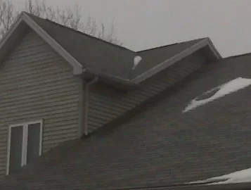

RPK1,

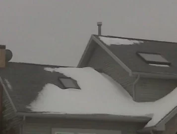

this is a picture of the roof the wall on the right when in the attic my thought was to get under the roof line to add but I'm think that may be difficult. Roof faces North side

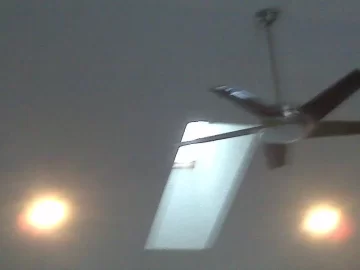

this is a picture of the inside looking out picture not that good but you can see the skylight and recess lights and fan.

Not to point out the obvious, but it appears your heat loss is around the skylight and the chimney. I think I would get rid of the skylight and other ceiling penetrations, put 2" of foam underneath your existing ceiling and rerock it. Or, if that is roof is reachable from the ground, get a roof rake and keep the snow off the bottom few feet of it.

It may be more than that, notice the snow melt off the right side, higher roofline. I think there may be something else, contributing to the situation. There seems to be more heat loss than just the chim and skylight. Can we get another pic of the entire roof (both sections) ? In the other section is there an attic space?

This is a long post just a reminder ...I have had no problems with ice damming till I got the Avalon last year.

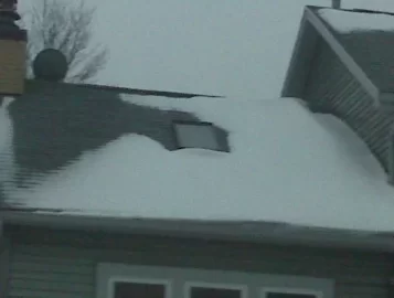

One problem thats not helping you is we have had a couple of 40 degree days plus rain this morning. Prior to that my roof (all of it) was cover in snow not showing any heat lost just the ice dam on the north side Cathedral ceiling only. Here is a picture of the top roof. the picture on the right is over the garage Thanks again for your time.
Edit: I think maybe my problem maybe the top roof draining to the cathedral roof added more water to that cold roof like in the picture on the left. Which could mean I could use more insulation in the attic not the catherdtal roof. What stump me was my whole roof was covered with snow not showing any heat lost.

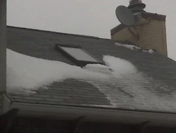

Here is a picture on the cathedral roof on the SOUTH side, inside ceiling has the same skylights and recess lights. Notice no ice damming even with the rain melting. All gutters are clear and draining right now.

Edit; on this side I don't have the top roof draining to this roof so I don't have the ice problem here on the south side like in the picture above. May have figured this out just by watching the rain today.
