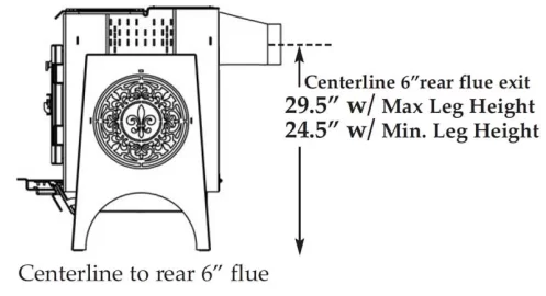

i remember a while ago I saw a post about someone flipping the flue adapter on their ideal steel to get more clearance. Does anybody have the measurement on the lowest setting? My lintel is 28” and I’m trying to figure out if this stove will work with a hearth pad

![[Hearth.com] Ideal Steel lowest height with flipped adapter [Hearth.com] Ideal Steel lowest height with flipped adapter](https://www.hearth.com/talk/data/attachments/247/247381-2af59ce7ad00ae5c662984508d38fd7b.jpg?hash=qeeoBr6dp9)
