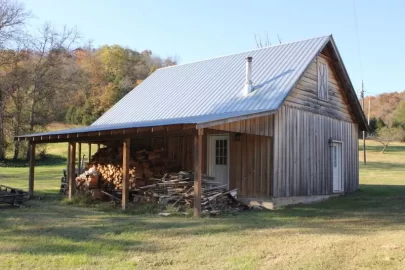

Im not sure if this is the right spot to put this but here is goes. After browsing the forum for some time and talking with some people i decided to go with a garn 1500. And to house it i want to put it in a garage in building this spring. I thought about making it 30x50 and on one end building a wall to make a 10x30 room for the garn and a little bit of wood storage. The rest of the building will have a hoist and be a workshop that will eventually have in floor heat. Do you guys think I should put a garage door on the 10x30 part so if i ever had too i could take the garn out easily? Or does anyone have a better idea on how to incorpoate a garn into a building?
