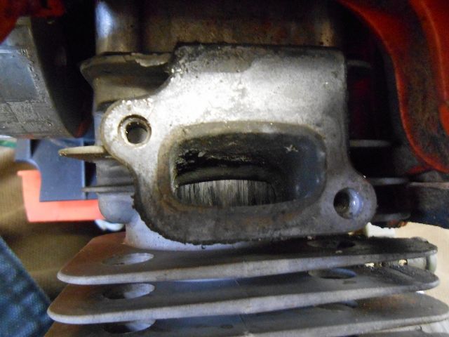

OK I have my old Husky 350.
It worked fine until some thing caused it to stop running.
Held the saw by pull rope and watched it drop to the end of rope.
Was told scorched piston.

Would you rebuild or keep it for parts for my other 350?
How much would it cost and were to get parts?
Should I port it, muffler mod while its apart?
All opinions welcome.

Sean, you're losing saws quick man! ;)
Unless you really want to "play" with that 350, I'd be looking to replace it with a 346XP or similar. If you're really on a budget, I've seen good Stihl 026's on CL for less than $250. Hard to kill too. ;)
Complete top-end kits for the 340, 346XP, 345, 350 are avail for about $50 but I'd be wary about using them on a saw I was going to rely on everyday.

Are you running oil in your mix? That looks straight gassed.
I wouldn't consider a rebuild until you find out exactly what caused the carnage.

My advice for you would be to keep it for parts if you have another one.
If you didn't have another one, I'd buy a different saw and rebuild this one as time permits, maybe even using "used" piston, etc from fleabay.
Perhaps use the ol' 350 as a trade in . . . I know my local Husky dealer will occasionally offer $__ for any saw . . . "dead or alive".
