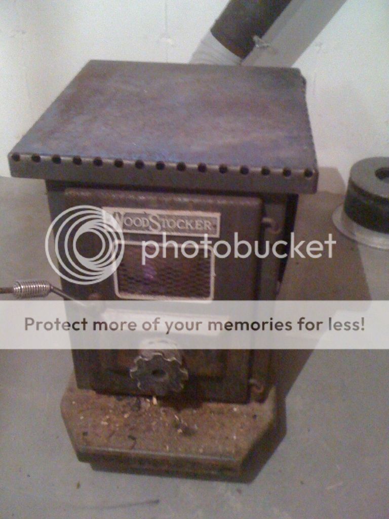

i got a wood stocker stove (really cheap) thought it looked great and would heat my house built in heater stove looked huge i only have a 1000 square foot ranch, i used it for a week with a ton of problems i cut my own wood a mix of hard woods and some burch. 1 problem i cut my wood to 18" lengths and the stove burn aera was too small, 2 cause it didnt hold much wood it wouldnt go more than 4-5 hours even with the stove full, 3 it didnt make much heat going threw wood alot it would only make my house 70, its in the basement but i vented it, lastly and the reason i un hooked and sold it it made alot of smoke and build up in the chiminy made me nervous with a non epa stove so i found a deal on a newer stove it looked small but cheap so i grabbed it its a england stove works 18-tr it uses half the wood and im still at 70 in the house, my only issue now is i need a trick to get the stove to go all night. fully packed with wood it will go 5-6 hours. it has no adjustment for the air vent just has a damper i close it up all the time i love this stove just wish i could it it to stay lite 8 hours any ideas
horrible stove

you guys think i just need a bigger stove? i paid 25 bucks for the wood stocker sold it for 200 and got the england stove works for 175. should i just try to sell the new stove and go bigger? i could get a fisher papa bear for 200 but its non epa

I think getting 5-6 hours of burning from that stove is pretty good. You may be able to stretch it out further with more experience burning it. Sometimes stoves will run a little different if you put wood in a different way, place the wood on a bed of coals arranged a certain way, etc.
I'd try different ways of burning it to see how things go.

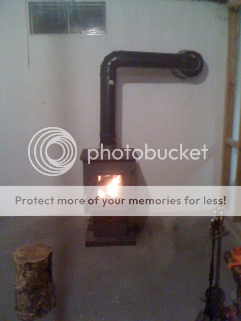

Basements are hard to heat. You'll read here that a cement basement will suck up lot's of heat that you'll wish would be going upstairs to heat your actual house.
Wood stoves are much more efficient when they are local to the area they are trying to heat. You're heating the whole basement in order to feed some of the heat to the upstairs, which is the real target. I'm not the expert some of these guys are, but it is my guess that is a big part of your problem here. Is there anyway to place that stove on the first floor of the house?
If the stove must sit in the basement, I think a larger stove is needed. I would very much advise a EPA stove for numerous reasons, but primarily because with a large non-EPA you'll waste a lot of wood heating that basement. Which is a shame as it looks like it isn't really your daily living space.
Exactly right. About 30+% of the stoves heat is headed outdoors through the uninsulated basement walls.

I can spot at least one problem just from your picture. Possibly two. First, is there any rise in that horizontal section of flue pipe? It looks more like a drop than level or rise. You need at least 1/4" rise per foot of horizontal. We give ours around 1/2" rise per foot.
Second, I see a nice sized round log sitting on the floor. Whoa! Big problem. Question. How long after you cut your wood do you let it dry? How do you let it dry and why do you not split the log? Wood won't dry much at all except on the very ends of the logs until it is split. That is the reason for splitting wood. And it also depends much on the type of wood you burn on how long you need to let it dry. Most wood needs at least a year after being split to dry properly and then it also should be stacked outside in a very windy spot. Sun is good but wind will dry the wood faster than sun will. And if that wood happens to be oak, around our house we won't think about burning oak until it has been 3 years in the stack.
As you no doubt have learned, it is sometimes good to try to save dollars by going cheap but not always. Sometimes it pays to spend a bit more to get it right the first time. Especially with something that has a fire in it, I do not want to go cheap.
Dennis beat me to it. I saw the horizontal pitch of the flue being less than level with no upwards pitch too. Cool looking stove, tough working space, being in the basement with no insulation. I hope you have alot of dry wood to feed it.

Any chance you can eliminate that long horizontal run where you've got it? That isn't doing you any favors either.
What you've got isn't bad, but heating the basement is taking a lot of the oomph out of that nice stove. All the same, keeping the basement warm will help minimize your need to burn oil, it's much better than nothing and will definitely help.
