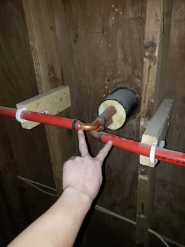

Hello everyone, I recently just moved into a house that is strictly heated by a wood boiler. in my first couple weeks the wood boiler seemed to do fine (outside degrees in double digits mainly around 10-30 degrees). Just this past week I had to order another cord of wood and I am already almost done with the cord (outside single digit degrees), maybe a few days left of it. I noticed the boiler usually has large coals every time I am there for a refill. and the build up seems to be a lot more than usual to the point where I can't almost keep up with the ash deposits. what am i doing wrong here? My daily routine is loading in the morning around 9am. then reload around 10pm. I always load up until the boiler is really full.
Another quesstion:

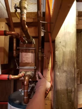

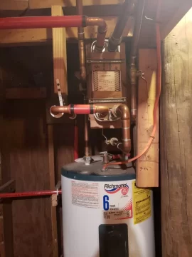

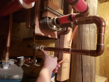

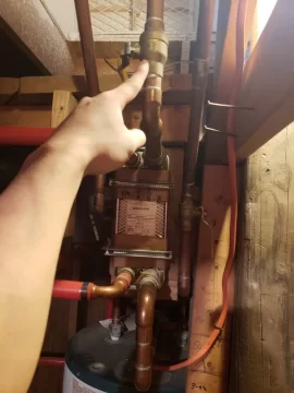

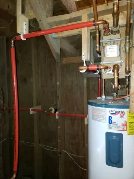

I believe the wood boiler also heats up my hot water as optional since it is electric as well. I have these valves going in and out of the heat exchanger as well as who knows where. also have another valve connected to the pipes that are going through the heat exchanger. I was told by a guy who set up my internet that it should be the valves to allow the boiler to heat the hot water. So i wanted to eperiment because hey who doesnt like saving on electricity. So i kept them open during the week where I almost went through a full cord. I recently shut the valves off yesterday to see if this might be my culprit to the over usage of wood. the pipes going in and out of the heat exchanger were hot but cools off only inches away. The third valve connected to the pipes was always cold.
Last question:
How do you get rid of your ash? I am accumulating way too much and not sure what to do with it. Some research say that "little" of it can be mixed with soil only to an extent. Another source is to put it in your trash bags. But in my area i'm limited to 3 trash bags and max 35lbs weekly...

Collectively many members try to help as much as possible, however most first time posters looking for help end up focusing on aspects that aren’t always part of the root problem. Pictures are great and often necessary when focusing on one area but do little for us to understand how your system as a whole operates. If possible, and I understand it might take 1/2 hr, draw and label a piping diagram that we can all wrap our heads around, believe me it will be much more productive and take less time in the end.
First thing off the top is that if you are burning wood that you are just buying this winter, you are likely behind an 8 ball right there. It is very unlikely it is dry & ready to burn decently.
The rest - yes what TCaldwell said. Most of what you are asking is found by following all piping & seeing where all it goes and what is hot & what isn't. Hard to do over the Inet.
EDIT: those valves & pics you put up looks like to allow either heating DHW thru the flat plate, or bypassing it. No, that wouldn't increase wood usage. And it looks like it would only transfer heat to DHW when DHW is being used. On demand, sort of. If you get the valves set right to put DHW water thru the HX, and turn a hot water tap on, you should feel hot water being output to your DHW tank. If no DHW is being used, the DHW side piping will cool off since the flow got stopped, until a DHW tap is turned on again.

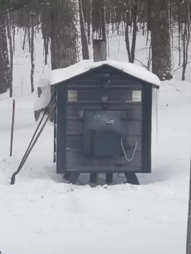

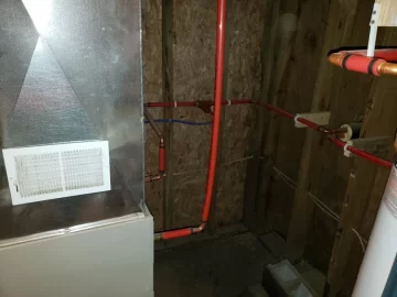

the pictures i included pretty much starts from the wood boiler (not pictured), goes underground straight to the house and through a wall in my basement. hot water in and hot water out comes from the same hole in the wall. the red pipe going right goes through the heat exchanger, then into the vents with the fan that feeds the heat to throughout the house, then exits back through the wall to get reheated by the wood boiler. Also have another set of hoses going to my garage which I am not using to heat at the moment but same diagram just without the heat exchanger. also the boiler is only about 20-30ft from the basement

My dad burned a Woodmaster like that one years ago and it was reliable and functional, but burned twice the wood of the new gassers we have available today.
You need firebox length wood and larger diameter than is typically delivered.

OK, read back again before hitting submit. Looks like some kind of furnace in pic 3 of post 4?
