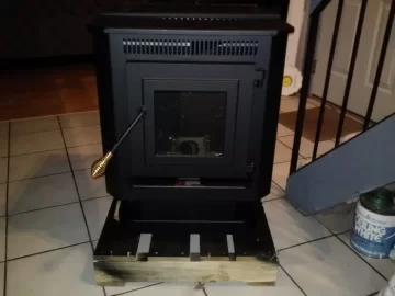

BTW, here she is--going in tomorrow I hope....[Hearth.com] Important Pellet Vent Pipe question-please read
Pics of the install or it never happened.
