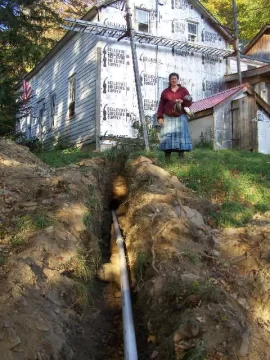

Here's my "other."
Got fed up with water in the basement - but up to this year is was dirt. Just dug it all out and spent a lot of screwing around, mixing concrete and pouring all by hand. We're on the side of a mountain and cannot get a Redi-mix truck near the house.

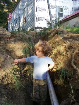

Nice thing about being on the side of the mountain though - is the ability to finally put in a gravity basement drain. Had to dig 5-6 feet down, but worked out OK and I put in 4" pipe. Yeah - it's big, but it can't hurt. Just got it dug, pipe laid, and buried when the ground froze, snow came, etc. Almost couldn't get my backhoe in there when it was dry, never would of made it when wet.icy. Only one way in - up hill.
My little kid had some fun with the ditch until I backfilled it.
  • [Hearth.com] In need of an inexpensive water pump
