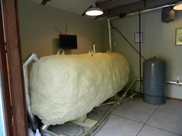

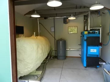

After running my Econoburn 100 without storage for 4 years, I decided to add it a couple of winters ago. I had a old 500 gallon propane tank on my property that hadn't been used in a while and was able to purchase it cheap from the local propane supplier. My next step was to call Dale at Econoburn and he said they could weld the necessary fittings in place as well as insulate the tank with spray on foam at the same time. I am lucky in that I am located an 1 1/2 hour from the Econoburn factory which is in Brocton , NY so I delivered the tank to them and it was ready for install in short order at a very reasonable price. I have since found out that they have access to propane tanks as well to repurpose for storage. Also for those needing the rating they make ASME rated 220 gal. and 350 gal. storage tanks. As you can see from the photos they do a nice clean job and provide great tech support for the installation that I was able to complete with my limited experience (the tv above the tank doesn't come with the deal!) Gotta go load the boiler, Bruce

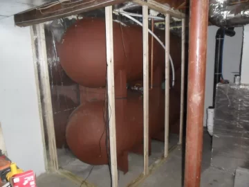

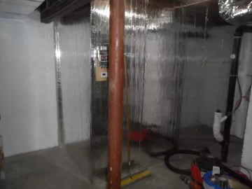

Looks good! I opted to build an insulated "room" around insulated tanks. My thinking was that is something ever leaked it would be a whole lot easier to work on.

Very clean boiler room! And you can watch TV while hanging around down there!
