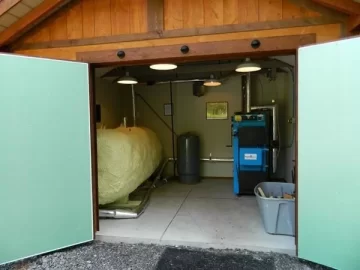

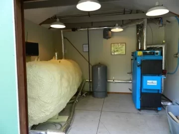

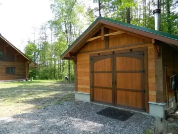

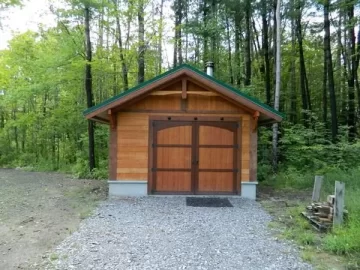

I have been heating with an Econoburn 100 since 2009. Started with the boiler in the basement with no storage for the first 5 years. Got tired of the mess in the house , so last summer built a boiler shed and moved the boiler from the basement. Burned without storage in the shed last winter and completed phase 2 of the project this summer by adding 500 gallons of storage. Without storage the boiler did a fine job of heating my 1700 sq. ft log house but it required tending to burn it clean. By that i mean if you don't want it to idle , you have to batch burn based on the conditions outside. At night , I would load it to the max and adjust my thermostats to actually waste heat so the boiler wouldn't idle too much during the all night burn. I would get 9 hours of heat even on the coldest nights . I know I may be stoned for saying this but i am actually looking forward to some cold weather to see the difference this winter with storage added. I did a few test fires this summer and supplied my DHW for 4 days after getting the storage to 190 degrees . Bruce

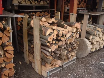

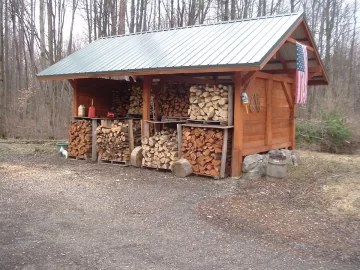

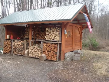

Thanks guys, as other guys on this forum have said , their boiler shed turns into a man cave as mine has. As far as the radiant heat from the boiler goes- absolutely , even without the storage , the heat given off by the flue piping and boiler doors will radiate to your garage or shed. That was one of the reasons i initially installed the Econoburn in my basement-so any heat loss would be into the house. The only problem was the mess in the house with wood transport and storage , and dust control during cleaning of the boiler outweighed the heat loss advantage. Having operated last winter in the shed , I found it to be a much better setup than in the house. Another advantage to the shed is wood transport. In the photos you can see my wood storage area which is 200 feet from the boiler shed. I use pallets with sides to stack my wood which are transported by my tractor with forks attached from the storage area into the boiler shed as needed. Keeps the wood handling to a minimum which is key when processing your own firewood. Bruce

My Boiler shed dimensions are 14' wide (if you measured across the front) X 12' deep. Everything fits , but I had to angle the 500 gallon storage tank a bit for a good fit. If I did it again , I would make it 14'X14' , for my boiler with 500 gallons of storage. I can fit 2 pallets of wood during the heating season. Bruce
