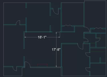

I'm wanting to add a fireplace insert to our existing masonry fireplace. We're in the Houston area so the fireplace wouldn't be running non stop, it would definitely be used to heat the house but it's also a nostalgia thing for me growing up heating the house with a wood burning stove. The last few winters we've been using the open firebox to burn wood with very minimal heat output and it's also extremely wood hungry. See attached layout (2,000 sq ft house), the red lines are where the hearth is, our living room is about 300 sq ft with vaulted ceilings while the rest of the house has the standard 8' ceilings. The living room is fairly cut off from the rest of the house but my air handler has a circulate mode that will run for about 5 minutes every 15 minutes so I can move heated air around decently, I can also just run the air handler fan constantly if needed.
