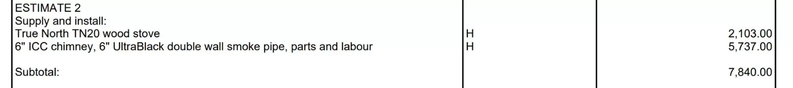

I got this quote for a woodstove in my basement and the chimney had to go out an 8 inch concrete wall and up over my house so must have been well over 20 feet of pipe. Canadian $$$. I had another quote too.
If you are going in a lofted main room that is 20ft that is going to be expensive as I'm sure they would need to set up staging and where it exits is probably pretty high up on the roof. Mine they would just do with ladders outside.
