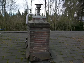

Draw the air for the OAK from the chimney, as well, not sure of your chimney dimensions but it is possible to do it this way!
The exhaust pipe for my Harman is only 5' but if you do try to run the OAK from the chimney the exhaust pipe would need to be longer
Run your OAK up the chimney all the way up and out the flue cap (you will have to drill a separate hole in the cap for this), seal it with RTV. Leave enough extra to create an upside-down J-bend to keep rainwater out. Also, not too close to the exhaust. Check the install manual for distance specs.

Duravent (I think) also makes 2 products that could help you. One is a cap that has a separate area for a 3 inch outside air hookup, the is a double walled pipe that the outer part will draw outside air down and connect to your stove.
