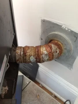

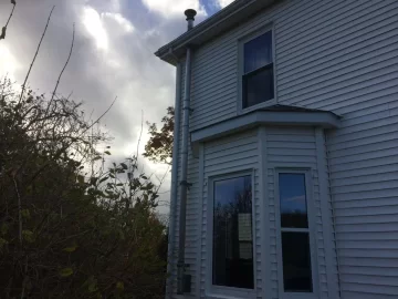

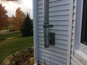

[Hearth.com] Installing used pellet stove and chimney [Hearth.com] Installing used pellet stove and chimney [Hearth.com] Installing used pellet stove and chimney [Hearth.com] Installing used pellet stove and chimney [Hearth.com] Installing used pellet stove and chimney Here are few pics of the existing piping... the exhaust goes straight out on the whitfield, then tee's and rises approximately 19'..

Need to figure out diameter on piping. 19' vertical = 8, 90* = 5, 45* = 3, 3' horizontal = 3. Shooting for EVL of 15 to 20 depending on stove. Higher EVL benefits from 4" venting.

What concerns me is if that is 3" pipe on the inside, and 4" on the outside, then it almost looks as if the adapter and connection to the adapter is inside the wall itself. Connections should not be inside the wall. Maybe the transition takes place at the T outside and it may be okay?
If that is 4" pipe outside, with all that rise, that is a good thing. Lake Girl has some good info on the EVL (and initial cleaning of the stove).

And regardless of what you do, I would assume you plan on replacing that elbow inside. It looks like it has seen better days.

The existing 3" inside my house connects outside, I can see where the connections are.. the existing 3" looks odd, the original installer put that brown \ reddish colour stuff on it maybe RTV, I am assuming to prevent leaking.. saying this, I have used the existing for 15 years, never had as issue with it either.. there was foil tape on it, so I when I removed it a few days ago, that seems to be the colour..
