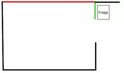

I did look at that and think about my clearances. I'm removing a wall and will be rebuilding part of it; this will allow me to make it as thick as need be. The diagram below shows what I've got to work with. Red is wall being removed, Green is wall to be rebuilt (with chimney), black are walls that will stay.

Basicly you'd have to have a double wall and build a chase for the chimney to go up through, then your chimney would be hidden
Like this.
