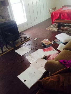

My daughter just had the glass blow on her's yesterday with 3 of her young children in front of the stove.. SO THANKFUL injuries were minor. What a scare!!! what a mess!
I joined the group today to learn more about the problems with this particular pellet stove... SO SCARY!!!! She posted pictures to Quads FB page. I hope they have a recall and notify owners ASAP!!! Should have been done!!!! Get the issues fixed!!!!

Maybe you could get her to post the pictures here?
I see her post on FB but no pictures.
I'm sure corporate didn't like that
I see the pic of glass on floor on FB,, need a pic of the door..lucky only minor injuries & the kids are OK.....
Something is terribly wrong here....

I hope she is contacting here dealer and corporate; a FB post probably doesn't count as a 'contact", or "notification", Also would be nice if she or you posted the pics here, where they won't disappear.
This isn't really my issue to post about. I was so shocked and then to find out it's "problem". I have found myself wanting to know more and posted when I saw the thread. So thankful there is little harm to the kids. My daughter has some minor injuries on her feet. I will ask my daughter about posting pictures but time is something she has little. The pictures are still on FB but you need to click on the post to page link to see the entire post and comments.

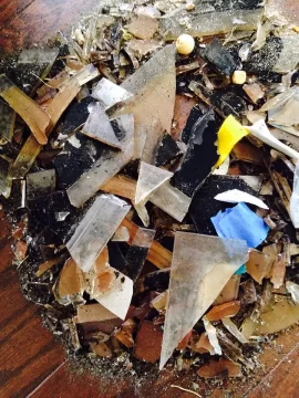

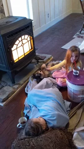

here are a few pictures with my daughter's permission. Two pictures of the debris and one picture taken a short while prior to the blow out.
  • [Hearth.com] Is there any new news on the Mt. Vernon E2 problems?

No disrespect but the picture with the young ones lying in front of it sure looks like there is a very hot fire going on in there ? God bless the young ones didn't get hurt bad from the mishap
Jeff
Jeff
Over exposure is pretty common photographic issue of fire and if camera has facial recognition even more so. Sure loved when things went digital.

It was a cell phone picture and certainly did not capture a proper exposure of the flame. :)
It doesn't matter, just the reference of the kids in front of the stove and then the mess will get plenty of attention all on it's own. And as far as it looks like things blew, those kids are lucky they didn't get glass imbedded in them and especially in the eyes.
