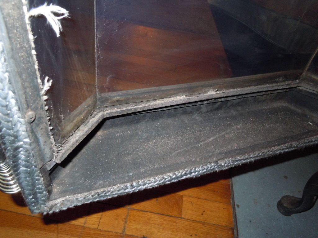

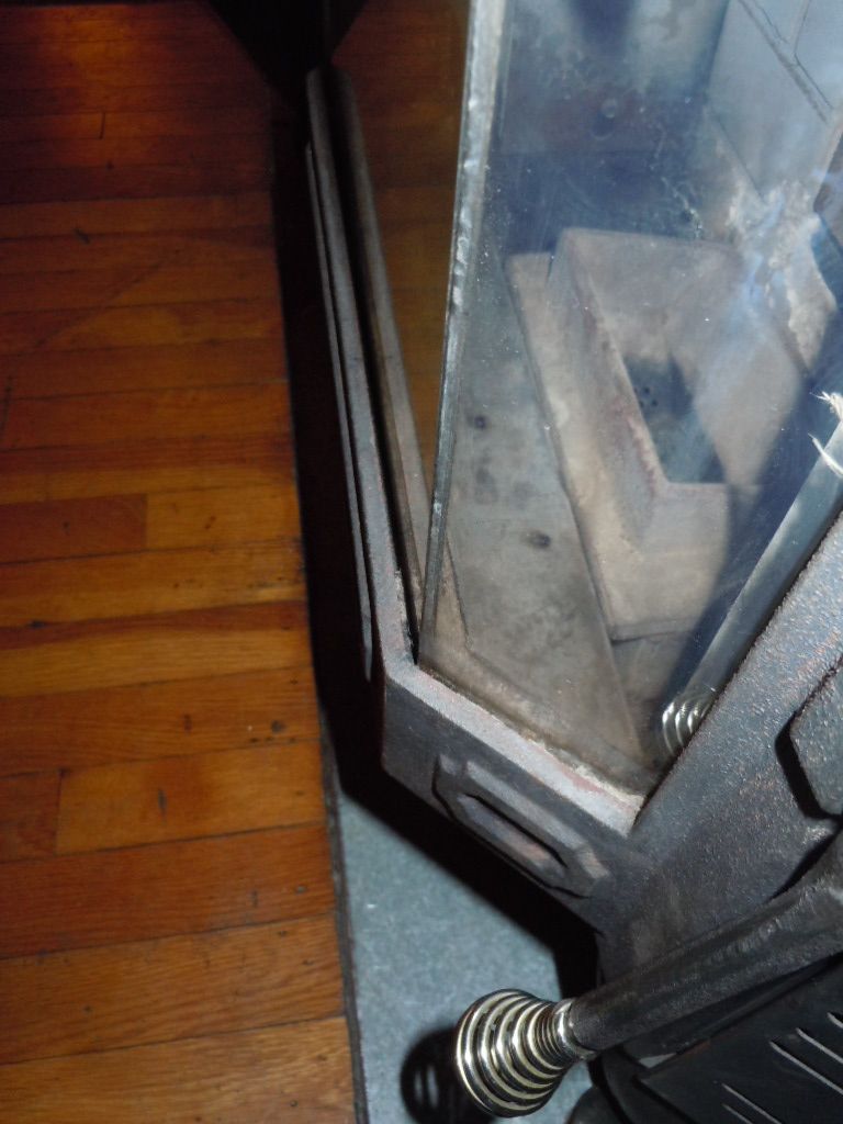

Hey guys I have the same stove J1000 manual light. Just bought it used and hooked it up. Everythign is working well except the glass is getting dirty quick. I'm burning powerhouse pellets in both my stoves. No problem with the glass on my other stove using the same pellets. Is there an airwash on this stove? The manual stated to try to run with more air to keep the glass clean. Also my 1994 manual has a page dedicated to troubleshooting the manual control board using a multimeter. I can give you the info. if it is needed, but I think midfielder has your issues pinpointed, Please let us know what solves your issues. Good Luck.
Also check your gaskets.
Hey DW - Your stove is an earlier edition so I'm not sure how the airwash works compared to mine (or if the older model has it). My j1000 doesn't have the pane dividers on the door - the glass for the side panels is beveled at 45 deg. and the pieces butt at the corner. The airwash is a slot at the bottom of the panes that's created by a metal bracket inside the bottom of the window frame with little tangs on it that hold the glass up off the bottom and back from the frame. Air is drawn through that slot and directed up the inside face of the glass by an angle in the bracket. If that slot gets blocked it will mess up the airwash function. I vac it out with a crevice tool from both sides while doing ash clean out. These were shot just before a glass gasket change:
