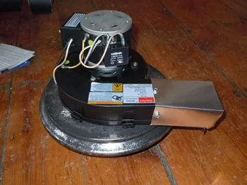

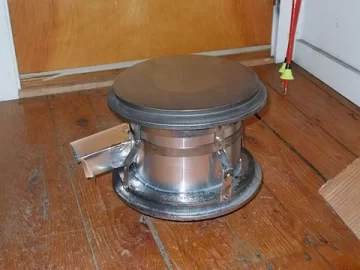

The main thing though was the combustion blower, which are pretty loud even when operating correctly on a lot of stoves I've heard. I know this isn't for everyone, but I got the stove used for a song, and was happy to bring it back to condition and mod it. My solution was to build a custom exhaust unit on the top of my short stack outside the house and remove the stock blower completely - this is a through-the-wall installation. I run an in-line speed control on it, so with that and the manual draft, I have full control of air flow through the stove. The sound the stove produces now is very low. The blower is a high-temp 100cfm squirrel cage blower from Grainger. I clean the vanes on the blower about every ton but probably don't need to. At the end of the stack it doesn't get nasty very quickly. When I shut the stove down to empty the ash (every 4 - 7 days, depending on how much fuel I've had to burn), I turn the speed control up to full - it acts like a mini-leaf blower and gives the insides a pretty good clean (obviously not what a powerful leaf blower would do, but good enough that I don't have to do that except at season's end). It also induces enough draft through the stove that I don't get fly ash in the house while emptying the ash. I don't use a vacuum except about every 60 bags or so for a deep clean.

I really like that combustion blower idea Midfielder. How do you connect the blower to the stack pipe? Did you build a box or something. Or do they make special fans for this. Cool idea.
I used a stainless pipe cap I had from a former wood stove installation. It has a flat on it that let me screw the blower housing to it. Used some aluminum flashing to give it a little side protection. Then a 3" to 5" galvanized expander to make the connection to the pipe. Pretty hacky . . . :p
