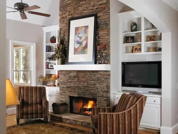

I am doing the surround with stacked stone. I am a complete nube at this stuff and I went in thinking I would not need a fireplace so to speak, that the insert was actually taking the place of the fireplace. I still want the insert, I guess I have just got to buckle under and pay for it twice?
Here is an image of what I'd like this to resemble. Hopefully it comes through.

It would be very hard to find a pre-fab that a 550 will fit into easily. We do several pre-fab/insert installs and it can be very hard. My suggestion would be to sell the Jotul and look into other zero clearance heaters like the Fireplace extrordinaire (broken link removed to http://fireplacex.com/product_guide/detail.aspx?id=97), Or the Kozy Z-42 (broken link removed to http://www.kozyheat.com/products/woodburning/z42/index.html), Or the Supreme www.supremem.com It seems very strange to buy a pre-fab fireplace only to stick an insert into it. These are serious heaters, not just fireplaces, give them a look.

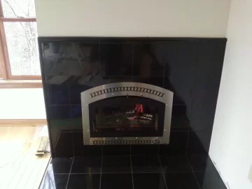

We just completed a FPX 36 install, I think it is an impressive unit. I like the single door too. We got to fire this one up for the customer, cranks out the heat!
