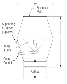

I keep seeing venting installs with a cone shaped end on them (pointing downward and straight out of the stove), what is with that? I don't much care for it but I keep seeing it in pictures posted on here? Looks to me like a cheap out on termination as well as a nice 'home' for summertime pests.

They are called jet or vortex caps. They work especially well on days that the wind hits that side of a house. They also push particulate matter farther away. They generally have a anti bird screen in them.

That 'vortex' end to me looks very cobbly. Reminds me of an inverted ice cream cone. Not something I'd use.

Jet caps on the flue have been around many years,and have never heard or seen a complaint, even on stove forums like this. They are a logical solution to a problem. I actually think they look more professional.. Just as I have never seen or heard of an insect problem on/in fresh air vents, I figure it is from the smell/odors. Just as you almost never hear of insects in a direct vent NG or LP intake,and there are many millions of them.

I’ve seen jet caps before and had no idea what made them special, after MtBob mentioned it above I had to look up a diagram, they’re pricey but are a decent looking concept
That is a fancy one. Most of us just use a cap that is tapered smaller at the outlet, accomplishes the same thing, by speeding up the air.

Technically it’s increasing pressure by restricting the flow to push it further away but I understand what you meant
